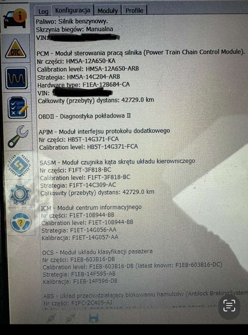

This module apim in another car has no strategy and calibration.
Photo:
Ghano38
Posts: 935
Joined: Sat Dec 07, 2019 9:10 am
Vehicle: Ford c max
Re: Black screen APIM, no power USB
Post by Ghano38 »
This is normal if the APIM came from a different car model however you can update it manually if the original software and calibration files are available or you can use UCDS.

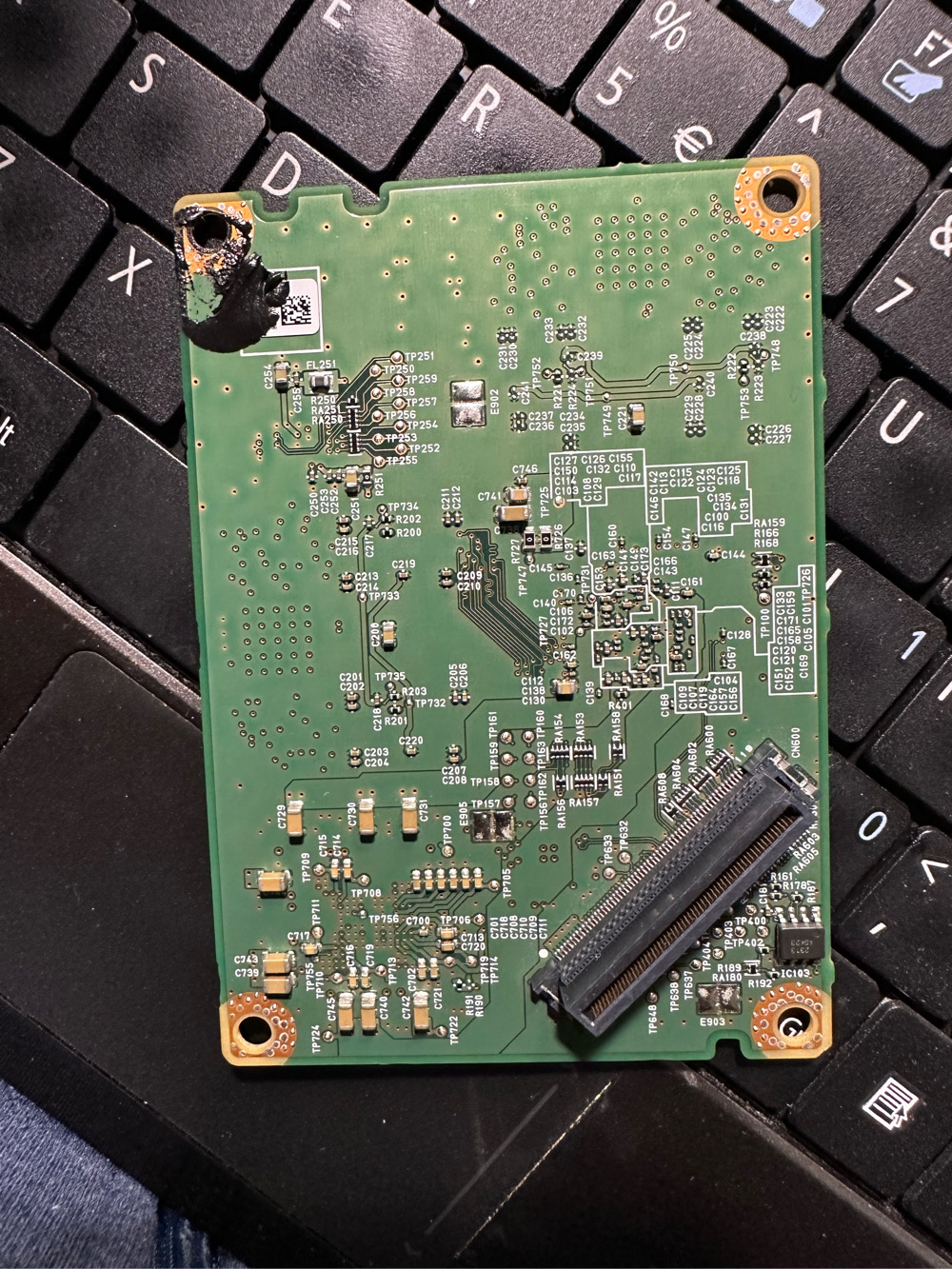

can i safely put another good memory board into this broken apim?
Photo:
Ghano38
Posts: 935
Vehicle: Ford c max
Post by Ghano38 »
Yes if you change the memory board it will normally wake up but i could bee related to eeprom being erased.
