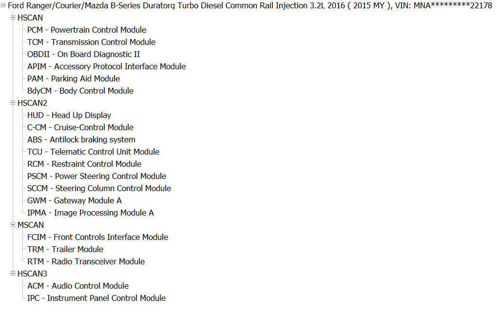

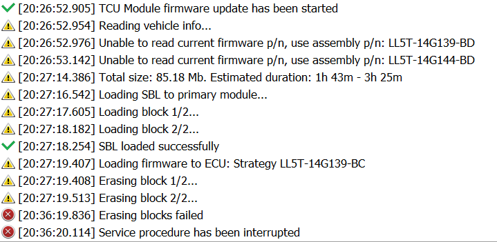

I currently have a problem with a bricked LV4T-14G087-DB TCU after trying an incremental firmware update.
The TCU is plugged into the HSCAN3 bus, but Forscan is detecting it on the HSCAN2 for some reason.
During a firmware upgrade it sits at "Erasing block 2/2" for about 9min before failing.
The device is now bricked if anyone has some ideas. See screen shots attached.

While I have tried restoring it a few times it does keep failing with the same error after about 9min of erasing,
It looks like another SBL existed for it that may help, any chance someone has "LL5T-14G141-BC.vbf" SBL file laying around or any SBL 14G141 starting with LL5T, LV4T or LB5T?
