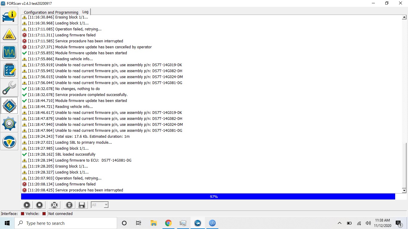

so i have the same problem with the ipma it upload them all then fails on the last one tried doing just the last one as a custom still a no go goes to 97% then shows a failure? Any other ideas? running 2.4.3 test20200917

this is a image
Screenshot 2020-11-12 113849.jpg (218.65 KiB) Viewed 3751 times
