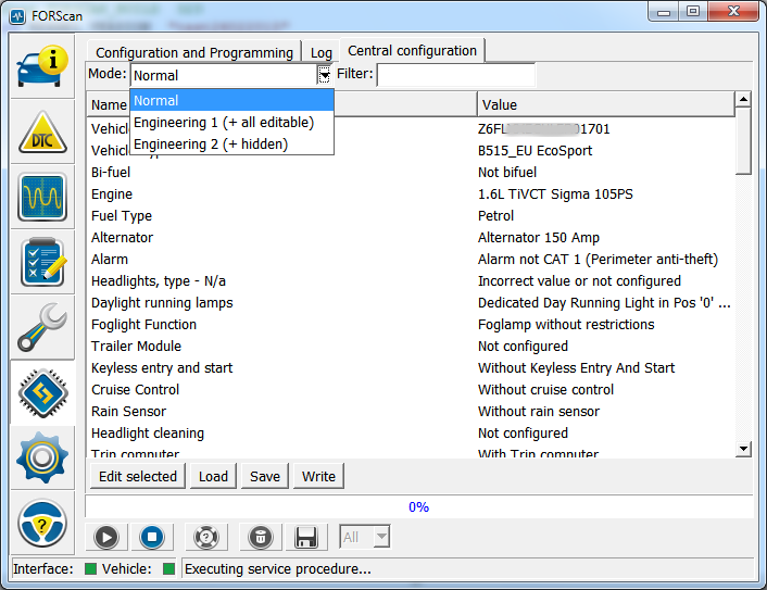

Hi all I hope this is in the right section .
I have a 2012 transit and when I connect there is no bcm as built option to click on .
There is for other modules just not bcm could this be because it has faults hence why I am changing the module ?
Tried a few version of forscan and I do have the licence version I'm just a bit worried about fitting the donor bcm if I can't write my vans data to it .
I do have all the data files downloaded already to go.
Many thanks
Posts: 2109
Re: Bcm AS-Built option
Post by tractmec »
Smithy69 wrote: Tue Jan 21, 2025 3:15 pm Hi all I hope this is in the right section .
Many thanks
If you are the same smithy that posted over on the Face Book group,? then you have a Central configuration vehicle! Your image there (attached and it shows a very old FORScan version 2.3.25 Current is 2.3.64) shows a BCMii(Main) and an IPC(Backup) and in central configuration vehicle the majority of all configuration operations are conducted under engineering mode which will be in a drop down list at the top left of the BCMii configuration configuration screen! The IPC(Backup) will usually contain a backup under a similar drop down in the configuration dialog screen and can be used to extract the original configuration if the BCMii(main) is missing or corrupt!
To access these, "High lite" the BCMii(Main) and click the "Play" button and a tab should appear called "Central Configuration and Opening that tab should open to a dialog with a Drop down arrow on "Normal" list in the top left corner and should open a couple of engineering mode options! IPC(Backup) is opened in a similar way
Opening these will open a list of engineering configurations! Configuration changes will require loading a Secondary Boot Loader(SBL) (similar to firmware loading in calibration file changes which requires FORScan 2.4.16) which will need to be downloaded from the internet the first time! FORScan may have the SBL this vehicle requires in a Paid license Database(a box opens and will ask for a file number and if you wish to download)!
See this topic for more on Central Configuration CC viewtopic.php?p=8036#p8036
Smithy69
Joined: Fri Jul 16, 2021 9:22 pm
Vehicle: Transit mk7 2.2 tdci 2007
Re: Helpful links on As Built configuration and programming
Post by Smithy69 »
Many thanks for your help I will go and give this a try now .idi have latest version of forscan it's just i tried a few versions incase it was a bug .I also have licence ,sbl and the as built data from motocraft all ready to go .
I was just looking for the as built as in all the youtube videos I had watched . Thanks again
