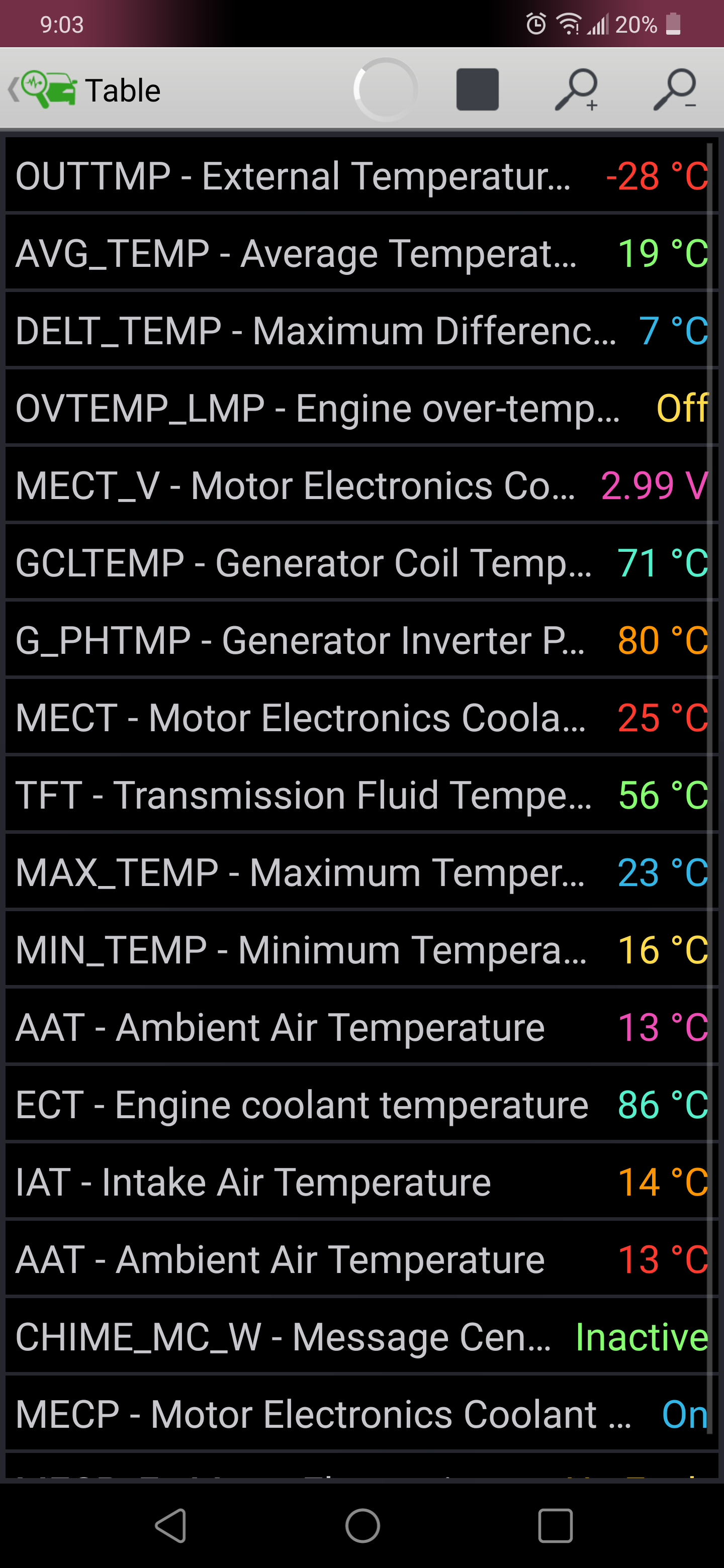

My live readings are all within it the ranges.
The wrench light will come on and trigger within driving 3 miles at 70 mph at 45°F
- Screenshot_20210113-210315.png (414.76 KiB) Viewed 3162 times
