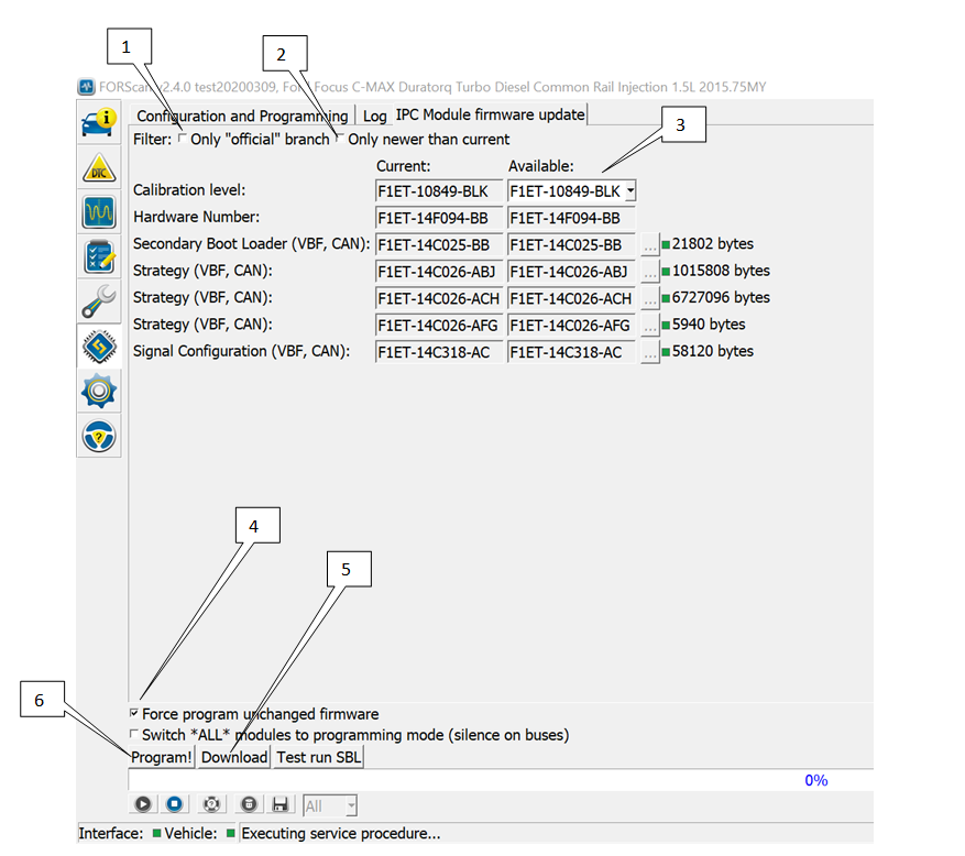

:shock: IF THE MODULE UPDATE FAILED :!:
note :!: who does not use the battery charger and does not make a backup cannot help
but here he is:
:arrow: the adapter was els27v3 STN1170 Ver3.3.1, we wanted to update it latest Version 5.0.0 release date: January 8, 2020 but it failed (don't know why yet) :( but this is a separate issue.
:arrow: we used FORScan software 2.4.0 date 20200114
:arrow: older car profile which showed a dead IPC module ( so we always make backups 8-) )
:arrow: car profile file location C:\Users\AppData\Roaming\FORScan\vehicles
:arrow: the same module software that was originally in the figure no.3
:arrow: and settings FORCE PROGRAM in the figure no.4
:arrow: we adjusted the forscan connection settings all auto and auto-increase
:arrow: we setup the OBD adapter baud rate 38400bps and FDTi dariver settings latency timer =1
:arrow: battery charger 6amps ( good is 8-12amps )
:arrow: after a successful upgrade load As Built original *AB factory configuration (download for Motorcraft site by VIN) write All (all blocks!) to the module. (optional-because the latest version does it automatically)
START .png (236.32 KiB) Viewed 7770 times

if the module update failed :!:
but here he is:
:arrow: older car profile ( so we always make backups 8-) )
:arrow: we adjusted the forscan connection settings all auto and automatic baud rate speed
it was 2 days all does not immediately remember :D
