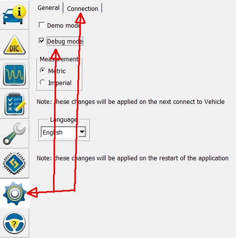

And check here to make sure all is set correct ...

Signalsguy
Joined: Sun Oct 17, 2021 9:20 pm
Vehicle: 2013 Ford F150 3.5L, V-6 Turbo
Re: Installing USB drivers for OBDLink EX
Post by Signalsguy »
Thank you Scorpionul22,
The settings were my issues, thank you for clarifying this for me.

Hello @Signalsguy, can you post what setting you had to change to make yours work? I’m having the same problem with my EX adapter. I followed the guide and still have no luck. Updated the firmware and no difference. I know it’s not the adapter because obdwiz works just fine.
