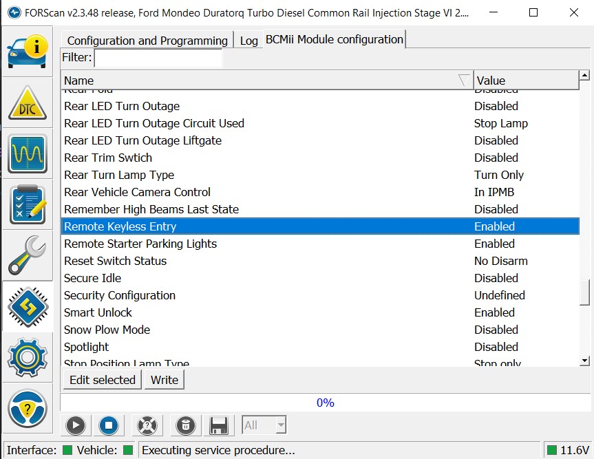

I was checking the modules on my powershift mondeo MK5 year 2015.
And there is no remote start option under BCMii module???
Under IPC module there are all the options listed in the first post...
no remote start.jpg (140.47 KiB) Viewed 5960 times
How can I enable "remote start" in BCMii module?
Raiko4
Joined: Tue Aug 30, 2022 8:02 am
Vehicle: Mondeo MK5 2.0D 2015
Re: REMOTE START
Post by Raiko4 »
Remote start:
BCMii As-built
726-22-02 (2014+ MY) xxxX xxxx xxxx
0 (Disabled)
1 (Enabled)
Is changing this the same as enabling "remote start" from BCMii module?
slip_n_slide
Joined: Sun Apr 14, 2019 4:08 pm
Vehicle: Ford Mondeo 2.2 Titanium X Sport 2010 (59)
Re: REMOTE START
Post by slip_n_slide »
I’m having the same issue. All sorted with the key, it’s working a treat, but does anyone have any idea regarding no remote start in the BCM module?
I’ve activated it in the IPC but nothing in the BCM except parking lights.

Re: REMOTE START
Raiko4 wrote: Fri Sep 02, 2022 6:13 am Remote start:
BCMii As-built
0 (Disabled)
1 (Enabled)
yes
slip_n_slide
Re: REMOTE START
fordsmax471 wrote: Mon Sep 12, 2022 4:37 pm
BCMii As-built
0 (Disabled)
1 (Enabled)
yes
Do you know if it’s supposed to be the same for S-Max? I tried that option but it didn’t work :/
Thanks again for all your help.
